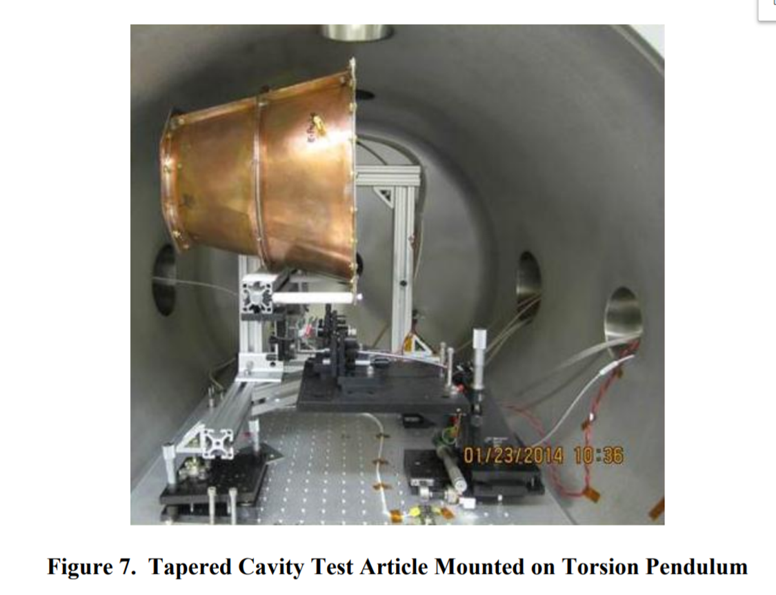

The picture at the top of this web page is from NASA's report. There is supposed to be something magical about one end of the EM garbage can being wider than the other, the fat end is supposed to provide thrust.
The NASA experiment seem like a reasonable try at validating the EmDrive; it brings the science down to engineering level with an attempt to measure the actual thrust of a unit. The DUT was mounted on an extremely sensitive torsion meter, inside a vacuum chamber (to simulate space), with liquid metal contacts providing DC power (supposed to remove the stress of DC cables). There are at least two major flaws in the paper: they don't provide a detailed mechanical schematic of what is isolated on the torsion setup, and they don't try to provide a list of all possible error terms, let alone try to quantify them. But now that NASA put their name on EmDrive, you can't stop internet crank technologists are saying it is "proof" that the thing works.
One potential problem is that the test setup is not self-contained: The test set up includes SMA cables running out to a dual-directional power meter and VCO (or are they mounted on the torsion meter? Hard to tell). Some uncertainties added by cable connections could have been eliminated by using an on-board battery to power the system, and using BlueTooth to grab the data. Does RF cable self-heating have an effect?
NASA's authors claim to have measured 116 micro-Newtons thrust when the RF power is switched on. That is the equivalent of 12 milligrams force. Note that cannabis gummies contain ~10mg of THC.
The authors noted that different forces were recorded for different frequency resonances, buy they did not record DC power versus frequency, or thrust versus RF power. As a control sample, the force generated by a 50 ohm load was used to calibrate the system, and was shown to be much less. Maybe there is some type of magnetic interaction going on: are we just looking at a really crappy electromagnet? More on that later....

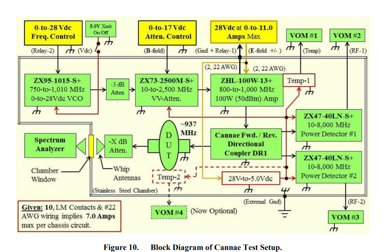

One positive outcome of the study is that we now have a publicly-available schematic that provides an example of what not to do, concerning ground loops. You could not do worse than this, every power form is tied to chassis ground. Read about why this is a bad idea, here.
