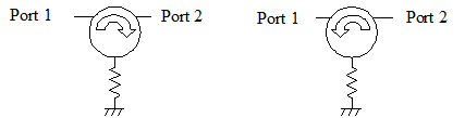

By terminating one port, a circulator becomes an isolator, which has the property that energy flows on one direction only. This is an extremely useful device for "isolating" components in a chain, so that bad VSWRs don't contribute to gain ripple, or lead to instabilities (unwanted oscillations). An isolator is a non-reciprocal, passive network.

CW and CCW isolators
