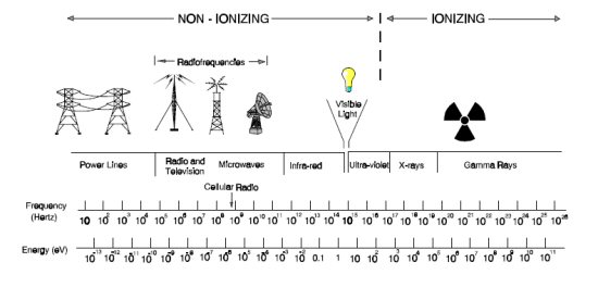

Ionizing versus non-ionizing radiation
Microwave energy is non-ionizing electromagnetic radiation. Ionizing radiation messes up molecules, non-ionizing radiation merely heats them. You heat your body every day when you take a shower with more energy than your cell phone could ever muster. Ionizing radiation starts at ultraviolet frequencies (UV), and includes X-rays and gamma rays, as you go up the scale of deadliness. The effects of gamma rays are what changed Dr. Bruce Banner into The Amazing Hulk; if you are worried about gamma rays buy yourself a Geiger counter.
Here's a figure that we shamelessly stole from one of the government publications. Notice that ionizing radiation is higher in frequency than visible light. Microwave radiation is far below visible light; indeed, there is a huge band of infrared between the two. No one worries much about the infrared food warmer and its effect on cafeteria workers, do they?
Biological Effects of EM Radiation
Electromagnetic energy is carried by photons. The higher the frequency, the higher the energy in each photon. When a certain energy level is reached, the photon has enough energy to knock off electrons from molecules that it encounters. At this point it is called ionizing radiation. The critical energy level is 10 electron volts (eV). One Joule is 6.2x10E18 electron volts, so a single electron volt is immeasurably small. Here's how to calculate the energy of a photon, depending on its frequency:
