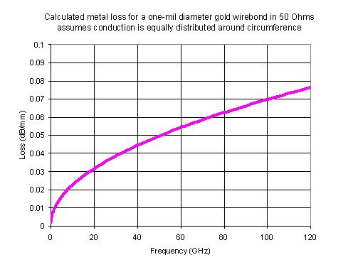

Resistive loss of a wirebond
We modified the coax spreadsheet (available in the download area) to calculate the metal loss of 1-mil diameter bond over frequency (does not include mismatch loss or radiation). It is very low, the plot is in dB/mm, a typical X-band bond is 1mm. The calculation also shows that at DC, 1-mil gold wire has 20 ohms resistance/meter, which
goes up with frequency.
The loss might actually be lower if you took into account that the impedance is transformed by the bondpads to something less than fifty ohms.
